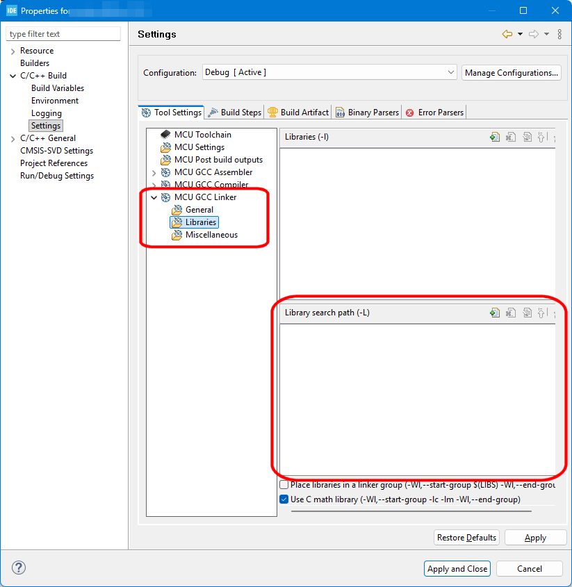

You specify the Linker search path here:

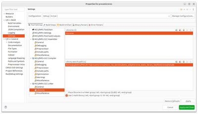

2025-11-02 1:21 AM
It should be a pre-built library. Could you help me verify this?
My linker search path is made as in the follow figure
libraries: microros
libraries search path: /home/guglielmo/PROJECTS/provamicroros/micro_ros_stm32cubemx_utils/microros_static_library/libmicroros

2025-11-02 1:53 AM
I fixed the library link search path as
and now build properly......
THANKS
