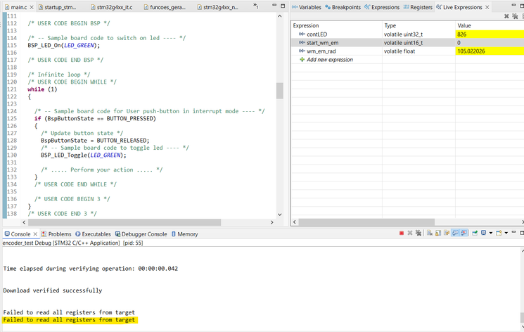

I'm having the same problem; when I change a variable in free expressions, the value changes, but the message "Failed to read all registers from target" is still displayed.

Hi @franciscozussa ,
After investigation, we were able to reproduce the issue from our side with CubeIDE version 1.19.0 and ST-LINK GDB server Version 7.11.0.
The issue is reproduced with the ST-LINK GDB server started with version 7.9.0, whereas it did not exist in version 7.8.0.
This fix will be available in the coming versions of STM32CubeIDE.
