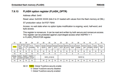

By checking the RM0433 Rev 8 (Reference manual STM32H742, STM32H743/753 and STM32H750 V):there is no Bit TZEN: Global TrustZone security enable and that's why there is no tick box to create a project based on TrustZone which means STM32CubeMX is behaving correctly.
On the other hand for example STM32U575 does support a TRUSTZONE and if you check RM0456 Rev 6
you find this
so there is a tick box to create a project based on TrustZone.
you find this
