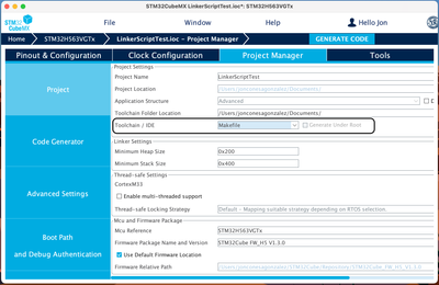

2024-08-26 2:23 AM
I’ve found how to replicate the issue. If I generate the linker file directly from your .ioc file, everything works fine. However, when I switch the Toolchain/IDE to Makefile, the linker file generation is incorrect, producing a generic one.
What can I do to fix this?
