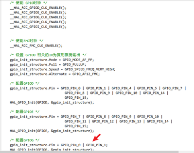

如题,在我使用H743XIH6时,我想使用FMC外设,但是我不太想用默认的PF0,PF1作为地址线,我想使用PG0、PG1作为地址线,但是我在MX中无法修改满足上述需求,在最后的代码生成中,他们是叠加在一起初始化的。而我取消PG0、PG1的话,则FMC外设也一起被取消了

The possible pins for FMC_A0 are in the datasheet. PF0 is the only option.
PG0 is not an option for FMC_A0.

I'm not able to really understand your issue.Could you give me more explination about your exact case. If you are looking to replace PF0, PF1 With PG0 PG1 on the FMC Configuration, this is not possible since they do not have the same Alternate function (look at the datasheet).

Well, sorry, maybe there is a problem with my problem description.
Yes, the original project was initialized directly with the HAL library, and now I have taken over the project, and I want to use CubeMX to initialize these peripherals, but I found that in the original project, he used PG0 and PG1 to use the address line, and I can't initialize it in the FMC option of CubeMX.
