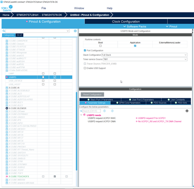

2025-06-23 2:10 AM
Hello @TS-LMG ,
I was able to enable both TouchGFX and USBPD for an STM32H7S7 board in STM32CubeMX:
(I first enabled TouchGFX, then CRC, then USBPD if that helps)
Note that it is pink because I did not configure everything correctly.
What versions are you using?
Can you share your project?
You could manually merge the files for the USBPD to a project with TouchGFX enabled by creating both project and then using a file/folder comparator to see what is missing but that would be quite some work.
