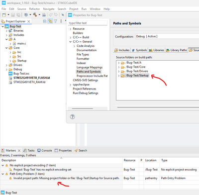

You mentioned that "This will cause CubeIDE to output a warning message on each build, stating that "./Startup/" could not be found."
Could you please share a screenshot of the warning message that you are facing.
THX
Ghofrane
2025-07-04 5:38 AM
Hey Ghofrane,
thanks for the quick response.
Here is a screenshot of the warning in CubeIDE as well as the entry in the project source locations that gets added by CubeMX:
