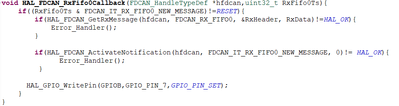

The code seems to be working as I am using some blinking LEDs to monitor the sending and receiving of messages

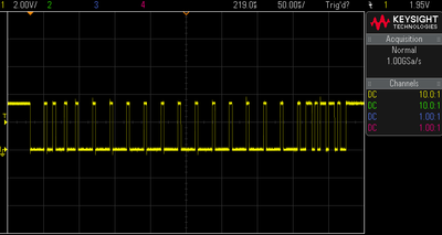

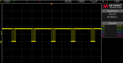

I've tested your code (I've attached a complete project) on NUCLEO-H723 and I could see CAN frames on Tx (PA12):
Zoom-out:
Zoom-in:
Now, I'm pretty sure there is something on the HW:
Either you have something forcing the Tx output on the board or you are not probing the right pin or you have something wrong on the oscilloscope: probe issue, config issue etc ..

1- Yes FDCAN Rx interrupt is firing. I connected it with a led to make sure
Zoom-out:
Zoom-in:
So what I suggest at this stage is to try to toggle the pin PA12 (FDCAN_Tx) and check with the oscilloscope if it's toggling well ..
