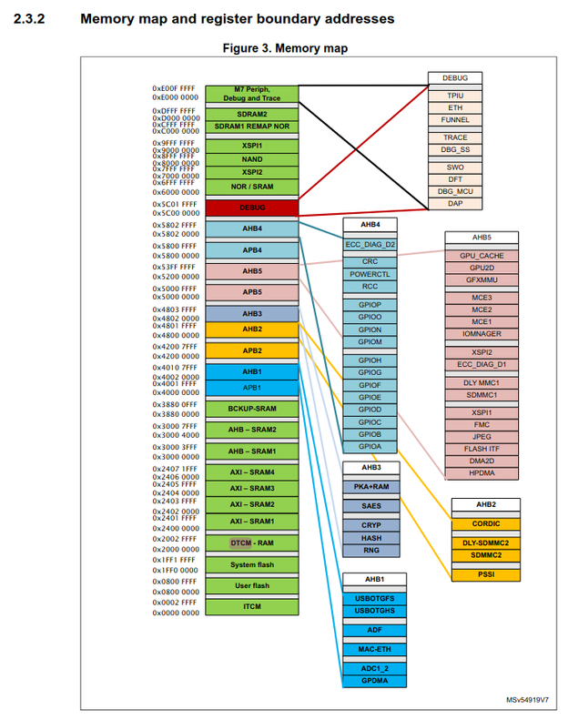

According to RM0477, the DCTM - RAM region begins at 0x2000_0000 and ends at 0x0x2003_0000, giving 192 KiB worth of memory. It can be seen in Figure 3 if one happens to have an electron microscope on their workbench.

}RAM and RAM_NONCACHEABLEBUFFER is also weird; it seems to only cover 320 kibibytes, but the collective AXI - SRAM 1, 2, 3, and 4 altogether make up 456 kibibytes according to the RM's diagram. So where is all that memory going? I'm also not sure what RAM_NONCACHEABLEBUFFER even is; is that something for ST's HAL in case it wants to bypass the cache?

A link script (ld file) is part of a software project. It may describe only a subset of total hardware resources. As long as it does not refer to unavailable memories or conflict with documentation, it's fine.
