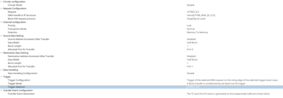

what is the current status of this topic? I am currently dealing with the similar situation (triggering SPI reads using timers), and having quite a lot of problems with getting the transfers to work. In the CubeMX 6.13.0 there is a trigger section, it is my understanding that it should provide the functionality that was discussed here. Am I incorrect?
2025-01-03 12:54 AM
Hello @ap_hqso
The functionality discussed in this topic is not yet implemented. Our development team is actively working on it.
