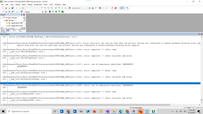

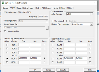

2025-03-09 11:26 PM - edited 2025-03-09 11:30 PM
2025-03-09 11:42 PM
in the code generation select ARM Compiler option as "Use Default Compiler version 5". after doing this if you'll get same errors then you need to download version 5 compiler from keil website.
2025-03-09 11:45 PM
I can compile using version 5, but I need help building an example for compiler version 6.
2025-05-05 3:38 AM
hii @SupriyaChakilam , sorry for late replay.. This artical converting-keil5-project-to-keil6 might help you to do your task. it is explained for TouchGFX but you can ignore TouchGFX related steps and focus on keil compiler settings.
