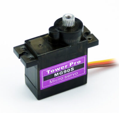

What is the "servo motor" ?
show pic.

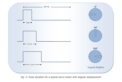

What signal it needs ? (frequ., pulse timing ...)

motor name is MG90.for every 1sec im trying to run it so how to configure clock for this

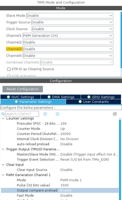

Ok, this :
So set TIM5 ch1 : i have clock -> timers 200MHz, so div 199 -> 1us timer tick ;
ccr 1500 -> mid position ; set to 1000...2000 for full left/right position.
then in main:
HAL_TIM_PWM_Start(&htim5, TIM_CHANNEL_1);
