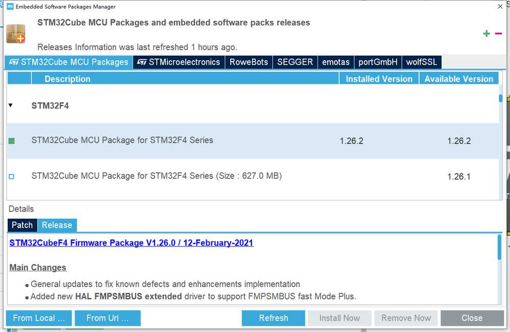

the driver generated by stm32CubeMX compiles with no error but the device's peripheral dont work such as svc ,I2C, DMA, UART. However, I substitute HAL driver with example project's HAL files, all seem well.

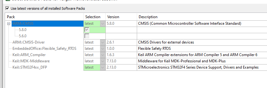

Hi, @Otavio Borges Thank you agian. I'm using F429IIT, KEIL 5.36, CMSIS pack 5.8.0.
I test CubeMX project without any modifying except for main() function, I write test code in main(). Freertos , I2C and SVC all cannot work, they call work if I switch HAL driver files to 2015 year's older version.
