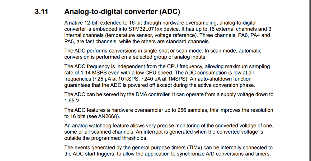

Can you send me a link? The L071 does not have scan conversion mode which is a mode that is usually used when read multiple channels simultaneously
UPDATE:
I have found where they mention scan mode in the documentation of the STM32L071:

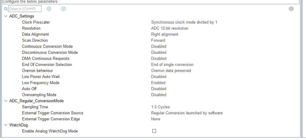

However, it wont let me configure this in the cubeMX

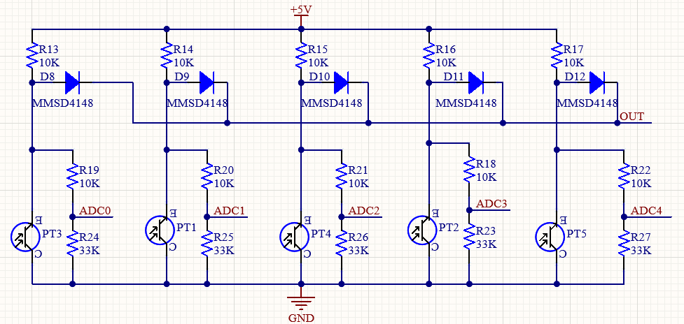

The following is a schematic:

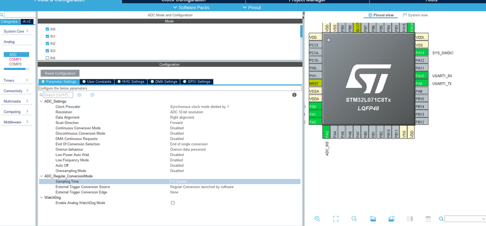

And the cubemx confguration:
I have tried to read multiple channels with the following code: This is just a snipper from a code, I am not inclugind HAL init functions that are irrelevant

}The above does not work. When I short the adc0 pin to ground, all other adc readings change as well:

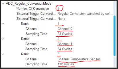

In the cubemx, I should be able to configure my channels as it shown in this example :
However, in my cubemx, I have no such options:

Maybe better is read and understand HAL functions , for example part from HAL_ADC_ConfigChannel(
if (sConfig->Rank != ADC_RANK_NONE)
/* Enable selected channels */
hadc->Instance->CHSELR |= (uint32_t)(sConfig->Channel & ADC_CHANNEL_MASK);
/* Management of internal measurement channels: Vlcd (STM32L0x3xx only)/VrefInt/TempSensor */
/* internal measurement paths enable: If internal channel selected, enable */
/* dedicated internal buffers and path. */as you can see here is |= then every call this add new channel, but dont remove prev. then your select func cant work. Too in HAL source is explain howto use ranks usw.
2022-04-19 10:21 PM
Thanks for clarifying. But I still cannot fully make sense out of it. What you said is only true when ADC_RANK_NONE is selected. In my case, all channels were assigned RANK 1
hadc->Instance->CHSELR &= ~((uint32_t)(sConfig->Channel & ADC_CHANNEL_MASK));.
