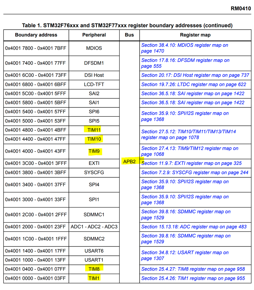

According to MX Cube there are 2 timer clocks, APB1 and APB2. At max APB1 is 108MHz and APB2 is at 216. I can't anywhere where it shows which timer gets which clock.

It's listed in the register boundary address table. I agree it could be presented better.
Different RM, but probably same information:

Usually there's a big bus diagram showing which APB different peripheral live on. I also often dictates which DMA unit will service the peripheral side bus interaction.
... at the beginning of every STM32 Datasheet.
