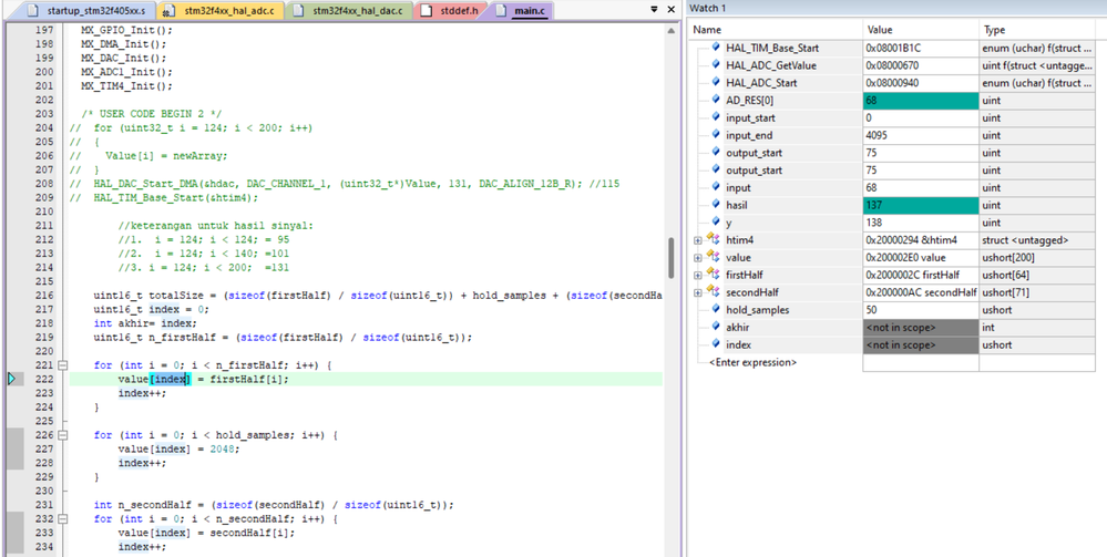

and this is my result if i run this code
and this is my code

uint16_t totalSize = (sizeof(firstHalf) / sizeof(uint16_t)) + hold_samples + (sizeof(secondHalf) / sizeof(uint16_t));
uint16_t index = 0;
uint16_t n_firstHalf = (sizeof(firstHalf) / sizeof(uint16_t));
for (int i = 0; i < n_firstHalf; i++) {
value[index] = firstHalf[i];
index++;
for (int i = 0; i < hold_samples; i++) {
value[index] = 2048;
index++;
int n_secondHalf = (sizeof(secondHalf) / sizeof(uint16_t));
for (int i = 0; i < n_secondHalf; i++) {
value[index] = secondHalf[i];
index++;
//HAL_DAC_Start_DMA(&hdac, DAC_CHANNEL_1, (uint32_t*)value, index, DAC_ALIGN_12B_R);
HAL_TIM_Base_Start(&htim4);

yeah, there are my code @TDK
2024-09-08 11:41 PM
The way you fill the array right now is:
firstHalf, hold_samples, secondHalf
From what you have shown what you want you might want to add hold_samples to the end.
But first you have to make the DMA run continously.
