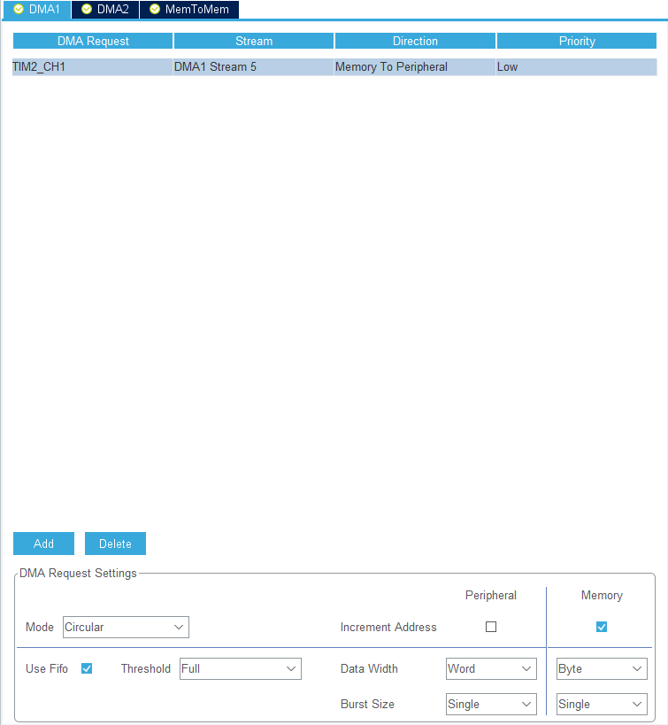

So and here is my problem I dont really understand what exactly I have to change since they are setting up their DMA manually in the post above, while I used CubeMX to set it up again without FIFO and couldnt find such DMA_Init code in my main.c file. With FIFO.
Edit: So after taking a break and thinking about the problem a bit, I think that my led_render, PulseHalfFinishedCallback and PulseFinishedCallback functions need to be adjusted to fit the new DMA Sorry for my misleading first question (if it really wasnt the problem :^) ). Code from the git above inbound:

Thanks for your fast answers. @Khouloud ZEMMELI I pinned the .ioc file to this comment. As far as my understanding goes, my DMA_Init only sets up the interrupts needed fot the DMA itself.
Concerning the clocks on the bus, I set up the Sysclock to be 180MHz and through the APB1/ABP2 prescalers and multipliers I set up the APB1/APB2 timer clocks to be 90MHz. I didnt mention it earlier, thought it didn't matter. I want to use two DMA channels and Timers for a parallel control of 2 LED-strips.
My timer periods are 111 (112) each, resulting in ~803,6 kHz (1,244 µs) so well within the range of the LEDs. My low duty cycle being 28 (25% and logic 0) and my high duty cycle being 56 (50% and logic 1), which are needed for the logic ones and zeros the LEDs understand.
