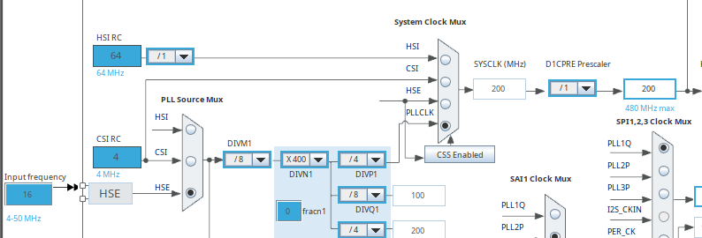

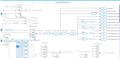

I am using an STM32H7 MCU and configuring the system clock to 400 MHz using CubeMX. The clock tree shows SYSCLK = 400 MHz, and MCO2 is configured to output SYSCLK.

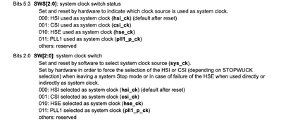

HAL_RCC_GetSysClockFreq() returns 64 MHz

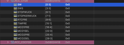

RCC->CFGR shows SWS = 0 (HSI is used)
SW = 0, meaning the system is not switching to PLL

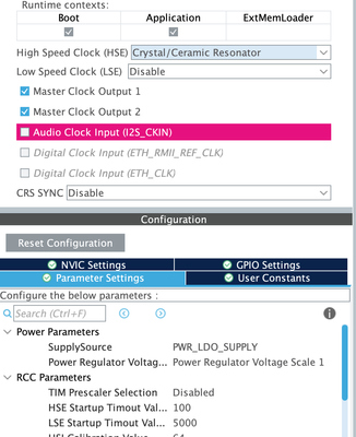

So set the HSE to the real frequency it has on your board...
then choose HSE on clock tree and dont use the frac /fractional setting.
like this:
