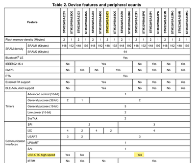

2025-10-27 7:32 AM
> STM32WBA65CIU6
This has USB, so the correct pinout is chosen.
Perhaps you want STM32WBA63xxx?

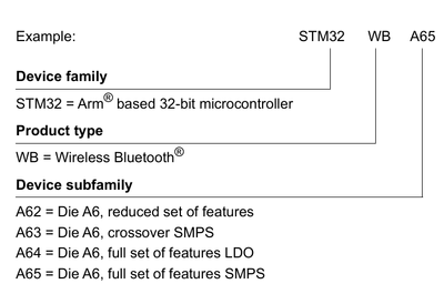

Thanks for your quick reply! So that means that even though these MCUs share the same Package they don't necessarily share the same pinout. Instead that depends on the specific feature set that they employ? That's probably common knowledge, but knowledge that I didn't have. Good to know :D
I guess that answers it. Thank you!
2026-02-22 2:56 AM
It's actually a little difficult to understand straight from the datasheet. One has to spend some time to grasp it. I also faced some issues and only understood it after going through multiple forum posts.
