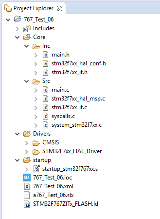

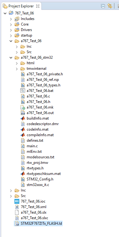

Building via simulink (simple model of GPIO in and GPIO out to turn LED on and off), seems to work, but leaves the folder structure below:

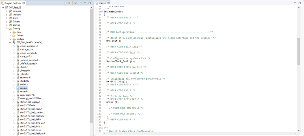

The project builds without error in SW4STM32, but resulting .ELF has no mention of the simulink generated code anywhere in it, and so does nothing when downloaded to the Nucleo board:
It seems to me that although the STM32-MAT/Target is creating code, Cube just ignores it when doing its thing.

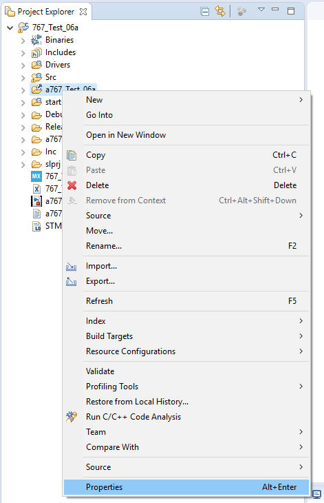

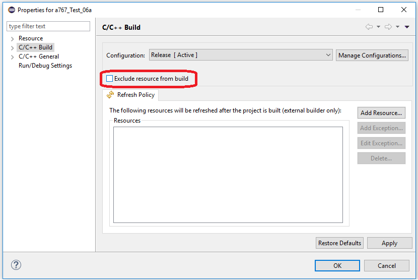

It seems that when Cube builds the project code, it defaults to not including the generated files in the build process in SW4STM32. The following shows how to make it included.

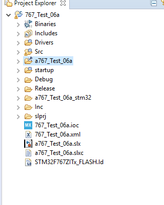

NOTE: only the Cube generated files need including, not the Simulink generated files. In the below picture you can see two folders, "767_Test_06a" and "767_Test_06a_STM32". The "_stm32" is the Simulink generated files, and can be left as NOT included in the build.

File with ..... "_stm32" -> right klick -> Properties -> C/C++ Build -> [X] Exclude resource from build
FIle without "_stm32" -> right klick -> Properties -> C/C++ Build -> [..] Exclude resource from build
