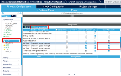

I've just made a change on the .ioc file setting the "Call HAL handler" option for this interrupt:
