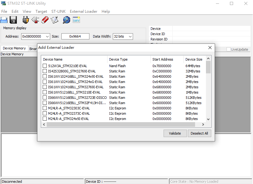

If i want to use external loader and not in basic list,how can i write a custom external loader?
I only use cubeIDE and cubeMX,can I write the file(*.stldr)?
I find the W25Q256.flm but can't use it.

I use QSPI example can test this ,but I want do some image to external flash like this,my spi flash is W25Q256 is not in this list, how can I create it?

I want try this is QSPI pin, when I use 32F746GDISCOVERY & N25Q128A it can find in external loader list, so when I use it's no problem.
but now I change MCU to STM32F767IGT6 and spi flash W25Q256 can't find in external loader list,I only know need to create *.stldr file,and use QSPI interface,can any one help me or give me some advice?

The list only shows devices/boards for which custom loaders have been built.
The W25Q256 is not one ST uses, they predominantly use Micron/Intel due to the common ownership of IP and fab over the years.
Custom loaders can be built, but it is a paid help rather than free help activity.
