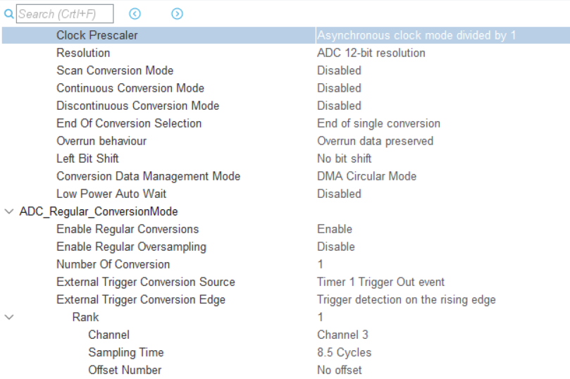

ADC Trigger from Timer,DMA transmit ,and then Always Overrun Error, buffer address @0x30000000.Data can not be transferred to buffer correctly,ADC1 register DR is 0x801 while buffer is 0x01.
2021-12-26 7:51 AM
Show your code. How fast is TIM1? Are you transferring half words or bytes?
