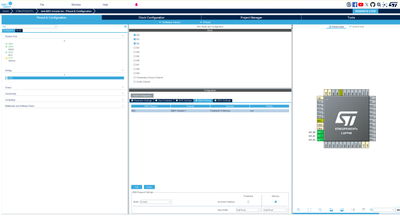

Hello @Preetpal
Could you please share your IOC so i can  check your configuration.
THX

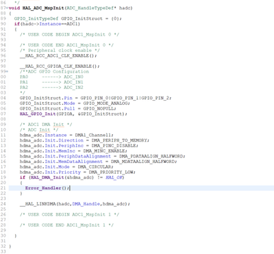

ADC peripheral itself does NOT have a "circular mode" setting.
The circular mode applies to the DMA controller that transfers ADC conversion data to memory.
The ADC can be configured for continuous conversion mode or single conversion mode
hadc.Init.ContinuousConvMode = ENABLE;
 but circular mode is a DMA mode that controls how data is transferred.
    hdma_adc.Instance = DMA1_Channel1;
    hdma_adc.Init.Direction = DMA_PERIPH_TO_MEMORY;
    hdma_adc.Init.PeriphInc = DMA_PINC_DISABLE;
    hdma_adc.Init.MemInc = DMA_MINC_ENABLE;
    hdma_adc.Init.PeriphDataAlignment = DMA_PDATAALIGN_HALFWORD;
    hdma_adc.Init.MemDataAlignment = DMA_MDATAALIGN_HALFWORD;
    hdma_adc.Init.Mode = DMA_CIRCULAR;
    hdma_adc.Init.Priority = DMA_PRIORITY_LOW;
    if (HAL_DMA_Init(&hdma_adc) != HAL_OK)
      Error_Handler();
    __HAL_LINKDMA(hadc,DMA_Handle,hdma_adc);
I performed a test using CubeMX 6.14.1and this is the result that I got :

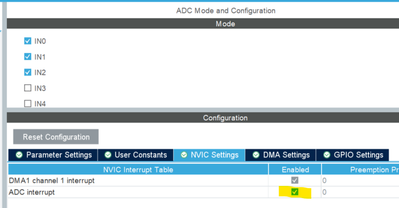

You need to enable the NVIC in order for the HAL_ADC_ConvCpltCallback to be called

Pls check attached .ioc file.
it doesn't work.
