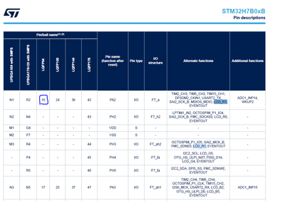

I am working on an HMI product with STM32H7B0RBTx LQFP64 and want to use the RGB888. As per Datasheet, it seems possible:

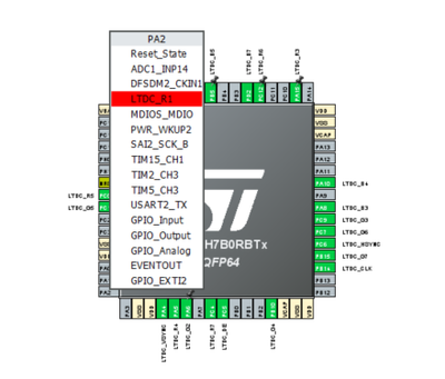

I saw that are supported on different packages, but data sheet still says it's possible! Below, it shows that LDC_R1 is mapped to pin 16, while in CubeMx, it's allowed to use it!
2025-02-17 6:12 AM
Ok I will escalate the issue and get back to you as soon as it's confirmed.

By checking again the datasheet, LCD_R0 and LCD_B0 lines are not available on LQFP64. So that's why RGB888 is not available on that package.
2025-02-17 6:24 AM - edited 2025-02-17 6:27 AM
@Ayoub Cheggari wrote:
Thanks for the quick reply @mƎALLEm !
And this is another issue that I need to rise it internally. Ticket number not accessible by community users 203407.
