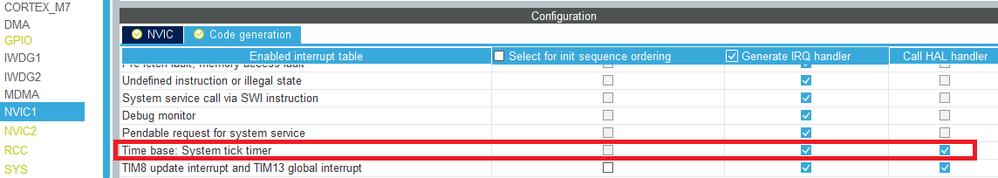

I should have clarified: the code generator sometimes skips generating the isr for SysTick when you eneable -> then disable FreeRTOS. But I've also came across the same issue as you, where the isr for TIM7 (or whatever TIMx is used for SysTick) is not generated. I was able to trace it back to the code generation options.
This is a screenshot of a current project using FreeRTOS and TIM7 as the SysTick.

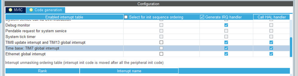

I see, in your project at least TIM 7 is listed in the code generation tab. This is how it looks in my project:
TIM7 does not even appear in the list. Annyways, fixing it manually works. At least I am not the only one with this problem. Thanks for your reply. :)
