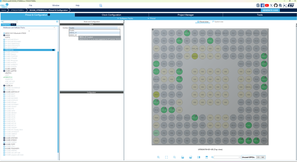

I have a STM32H7 project with FW_H7_v1.12.1 and MX v6.16.1, everything is good so far.
But after migration to FW_H7_v1.13.0, I can't generate FreeRTOS code any longer.
All FreeRTOS-related code are deleted and MX stay loading icon when I click FREERTOS component.
I tried uninstall MX and then install latest MX v6.17, but the same.
I also tried install X-CUBE-FREERTOS component, but still the same.
Please find my ioc file as attachment.
Is there anything I can do?

After checking internally (Ticket ID #34891), we confirm that FreeRTOS has been updated from version v10.3.1 (used in STM32CubeMX 6.16.1) to v10.6.2 (used in STM32CubeMX 6.17.0).
In this new version, CMSIS-RTOS v1 (cmsis_os.h, CMSIS-RTOS API v1) is no longer supported.
You therefore need to migrate your application to CMSIS-RTOS v2 (cmsis_os2.h, CMSIS-RTOS API v2).
