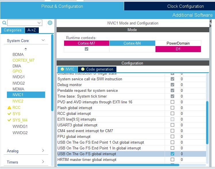

As mentioned by Joe above, the OTG FS interrupt must be enabled under NVIC. A screenshot is below, for others who may be facing a similar issue:
Can confirm also that the H743 and other Cube libraries (with Nucleo boards we had on hand) will enable OTG FS interrupt by default, allowing VCP to enumerate, which is why the steps above worked on other boards we tried.
Not sure if this is design intent to keep the interrupt off by default when the user enables USB connectivity! But for now, manually enabling works.
Thank you!

You're observation is correct. On other devices, CubeMX automatically enables the OTG FS interrupt when the USB peripheral is enabled and USB middleware class is selected. I will report this to the to the tools group so the USB interrupt gets enabled automatically for all devices (including the H745 you found this in). Meanwhile, you can enable it manually, until a fix is released in the next revision or two of CubeMX.
