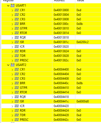

2019-11-15 2:29 PM
Spent most of the day debugging, to respond to the USART and GPIO Registers:
2019-11-17 6:37 AM
ISR for USART1 indicates Framing Error, which might indicate that the receiver does work, but the incoming characters are of incorrect form - baudrate, polarity, or simply there's only some noise on the respective Rx pin.
Check in RCC registers, if both USARTs are clocked in the same way. The G0 appears to have an USART clock switch in RCC_CCIPR.
