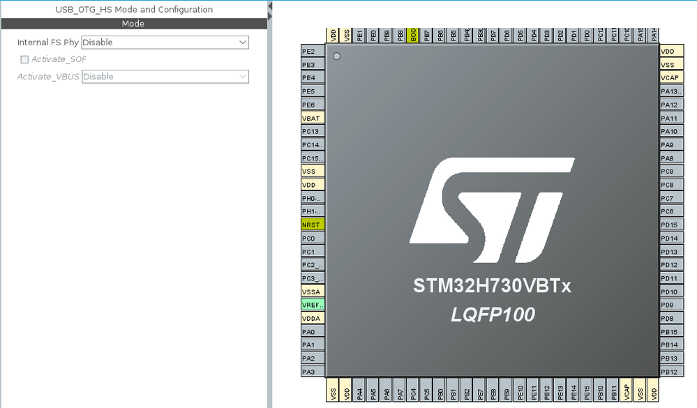

MCU selector in CubeMX finds H730VB when i set requirements to USB HS and 2x FDCAN. Unfortunately, it is not possible to select external ULPI PHY in USB_OTG_HS configuration. Only internal PHY is available. When checked against datasheet, H730VB should be able use external ULPI PHY after switching some PC pins.

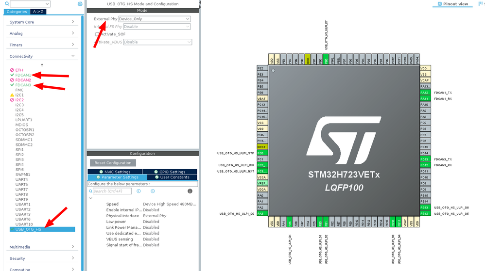

STM32H723VB does not seem to have this issue in CubeMX.

Thank you for answer, however CubeMX does not allow me to use ULPI on H730 even though, there are no pins occupied by other peripherals...
In contrast, no problems configuring H723 in LQFP100
It also allows you to use FDCAN1 and FDCAN3 together with ULPI. Yes, FDCAN2 is unavailable due to pin collision, but I need just 2 FDCANs...

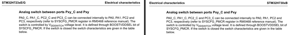

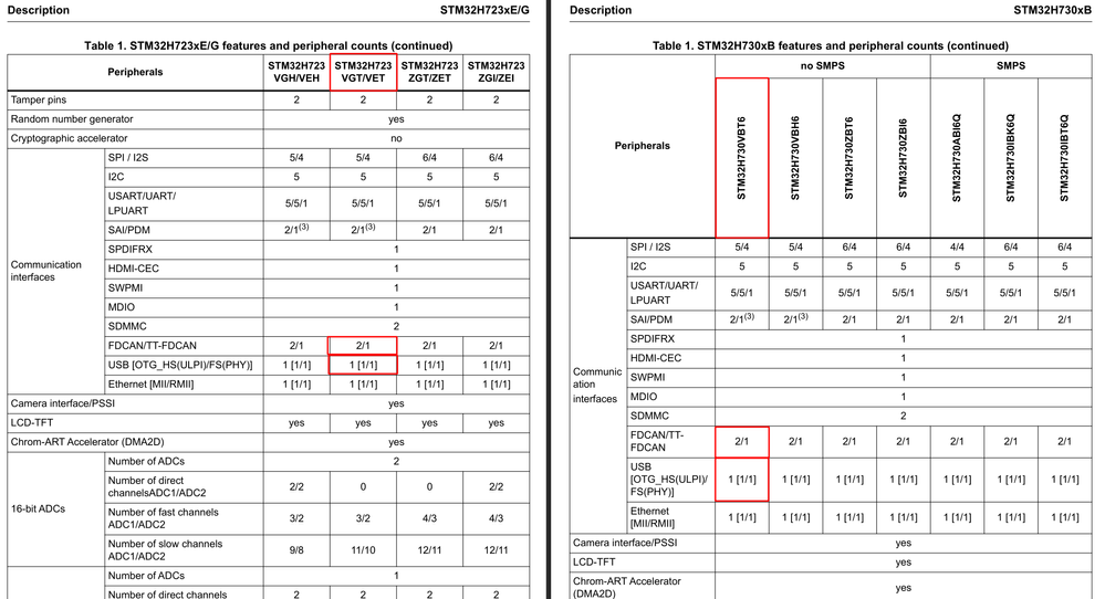

In datasheet, both MCUs (LQFP100) share same specs inFDCAN and USB sections:
It seems to me like some bug in CubeMX or missing information in datasheet.
