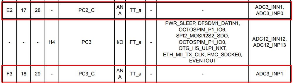

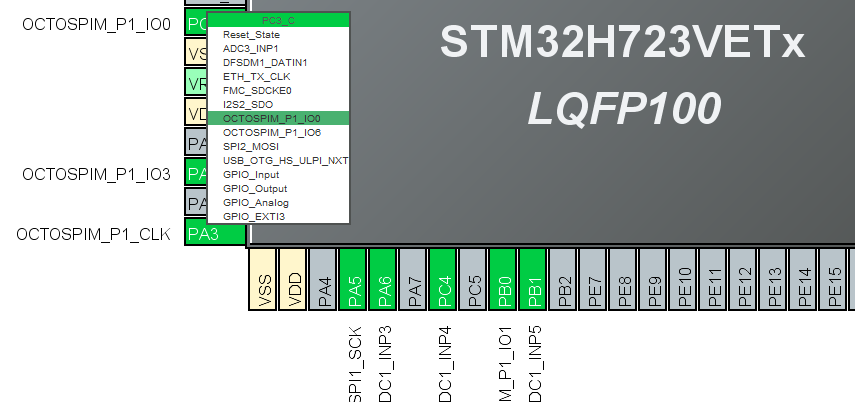

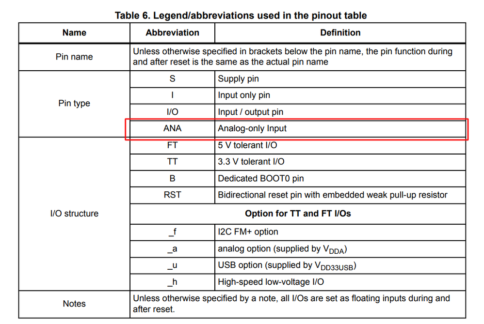

Hello everybody!
The documentation indicates that this leg can only be configured as an ADC input. In "CUBE MX" it can be defined as different kinds of interfaces. Who should I believe that my project would work properly and I would not be faced with the fact that this leg cannot be used as I need?
2021-01-16 5:56 AM
By default, PC2_C is connected to PC2 internally and you can treat it as such. The same is true for PC3_C, PA0_C, and PA1_C.
The SYSCFG_PMCR register can be used to separate the two.
2021-01-16 5:56 AM
2021-02-04 2:28 AM
Those pins are only seperate available on the largest BGA packages.
