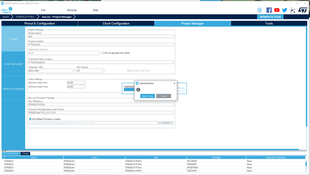

When I create an empty project and press generate, the generation fails. First I get a empty dialog screen:
0693W000007Du3eQAC.pngAnd then an error:
0693W000007Du4NQAS.pngIs this a bug?
