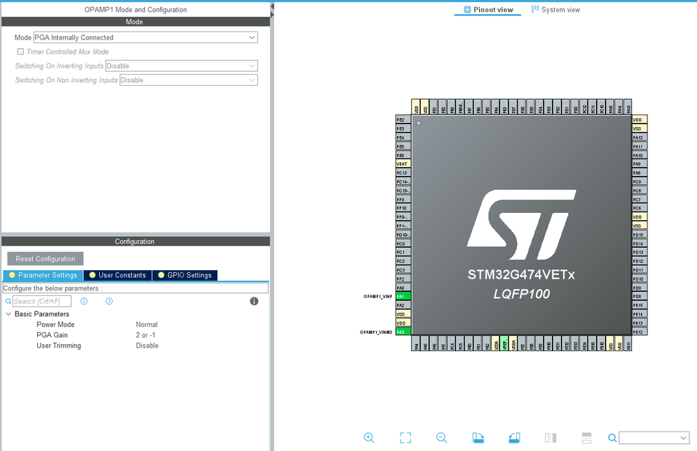

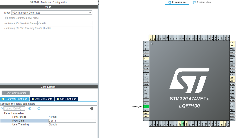

With the G4 Cube package version 1.1.0 I could configure OPAMPs as "PGA Internally Connected" and only the positive Input is enabled. With version 1.3.0 also the negative input is enabled. OPAMPs where this is not possible due to pin conflicts are silently disabled.
My interpretation of the datasheet is that the old behavior is correct and it should be possible to use the OPAMP only with a positive input.
Version 1.1.0:
Version 1.3.0:

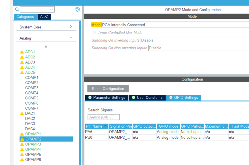

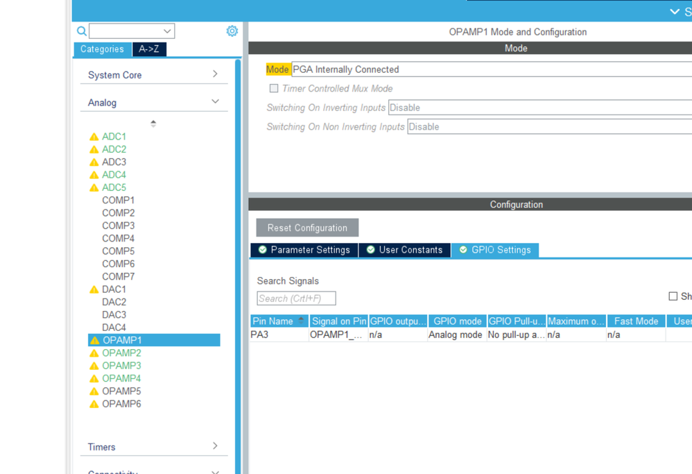

2021-07-20 8:51 AM
The "funny" thing is that it works for OPAMP1 but not for OPAMP2 3 4 (in version 1.4.0) - if you select PGA Internally Connected will connect the VINP externally (and not connect the VINM) but it works only for OPAMP1 for the rest OPAMP2 /3/4 will connect the VINM to the external pin. see the picture below
I hope we get these things fixed because were carried from v1.1.0 in various shapes and forms.
Maybe (just a suggestion) having a combo box for selecting the OPAMP types is not such a great idea. Things are more clear if the top level choices are just "Not used" "Follower" and "PGA" and the pinout connection are parameters listed like you have the gain.
Basically splitting the IN+, IN- and OUT settings in separate combo boxes next to gain and other stuff.
