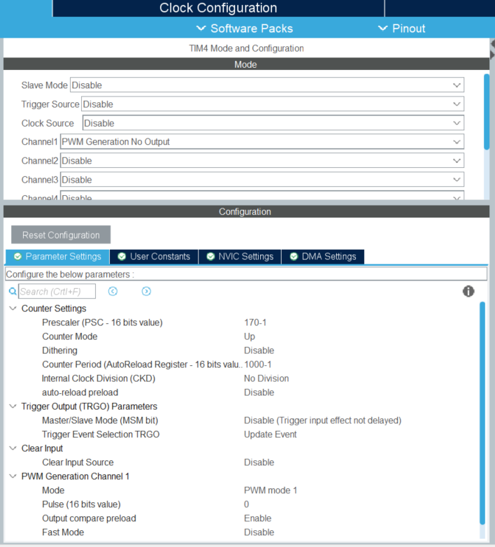

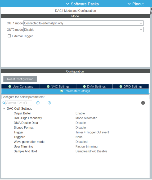

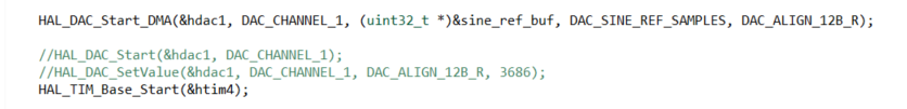

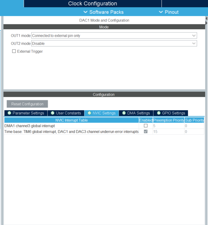

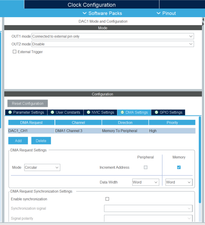

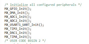

I have trying DAC with DMA from STM32G474 eval board. I can see the values being updated to the DOR register and the DAC EN is set to 1. However, the output of the DAC is stuck at 0.
I have attached the cubeide settings.
