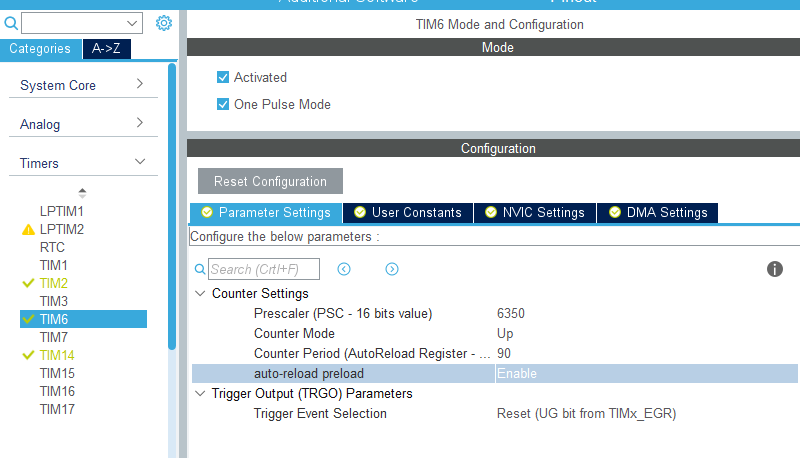

I am using STM32G071RB MCU 64-PIN TQFP and using Timer TIM6.
The ARR Register in not updated Immediate and It updated on Next Transistion.
Please understand below situation .
1) I have set below in STMCube.
2) As as Per calculation.
3) When I write ARR = 10 and after ARR = 90. .
a) The Timer first generate delay according 90.
b) Then according to ARR = 10.

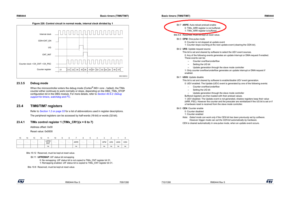

Preload of TIMx_ARR is controlled by TIMx_CR1.ARPE, but note, that TIMx_PSC is unconditionally preloaded, if you want to get it active immediately you have to force an Update event, usually by setting TIMx_EGR.UG.
Most of the time you want the preload to be active.
