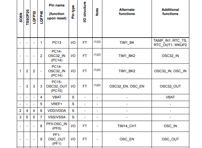

see in ds :
_legacyfs_online_stmicro_images_0693W00000bjuSsQAI.png..K.. has only BYPASS Clock Source option , is oszillator input. not for pure crystal .
and LSE crystal.

see in ds :
and LSE crystal.

If I understood correctly, you meant that it only accepts a CMOS oscillator, not a crystal oscillator.

set BYPASS Clock Source option : can use crystal-clock-oscillator , cmos or ..., but not just a crystal.
this is a crystal: 2 pins , (passive part) .
and this are crystal oscillators :
_legacyfs_online_stmicro_images_0693W00000bjxsAQAQ.pnghave typ. 4 pins: vcc, gnd , enable, clock out .
You understood correctly, but to put it more accurately - not just and oscillator, but any CMOS level clock signal, which conforms to the datasheet specification.
Many SMD crystal packages also have 4 physical pins...
