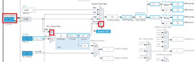

The changes I have made from the default NUCLEO-L073 CubeMX settings are:
Pinout & Configuration tab: RCC High Speed Clock (HSE) set to Crystal/Ceramic Resonator
Clock Configuration tab: System Clock Mux set to HSE

"target.clock_source": "USE_PLL_HSE_XTAL",
You need to select HSE + PLL not directly HSE as you shown in your first screenshot.
I don't have an idea about your PLL config (multiplier and dividers)

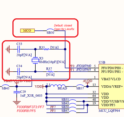

Did you put the crystal on Nucleo board?
Check the clock options description in Nucleo board manual. Maybe you need to change some config bridges on the board.
2025-01-17 5:09 AM - edited 2025-01-17 5:12 AM
Hello @pmcew and welcome to the community,
According to the board schematics, the crystal is not soldered:
[N/A] means Not Applicable by default.
The default state is to use STLINK MCO output as clock source for the MCU target as shown in the schematics.
Need to select Bypass mode in this case.
If you soldered all the components related to the external crystal (X3, C33, C34), you need to remove the solder bridge SB50.
Hope that answers your question.

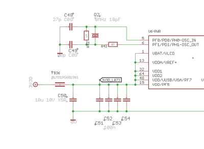

But anyway, are you sure about the crystal value and it's status (OK, KO?) what about this feedback resistor? Did you try to remove it?
According to the AN2867 "Guidelines for oscillator design on STM8AF/AL/S and STM32 MCUs/MPUs" the feedback resistor (R42) is already embedded in the MCU.
