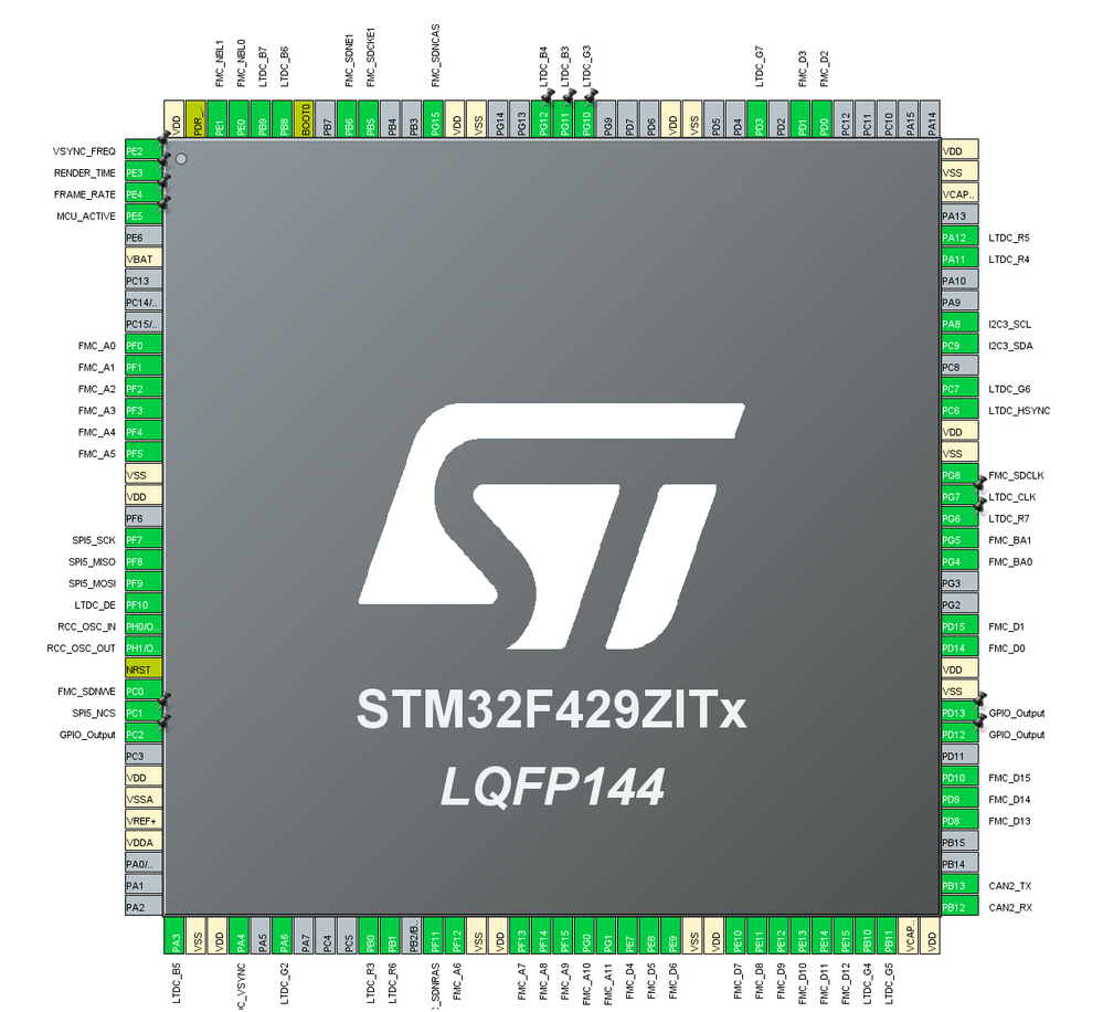

Hello, I'm working on a project using the STM32F429I-DISC1 board and need to implement CAN communication. I'm using TouchGFX for the GUI, and when I generate the code, only CAN2 is available as an option.
CAN2 is mapped to pins PB12 (CAN2_RX) and PB13 (CAN2_TX), but according to the board schematic, these pins are already connected to USB_OTG_HS_ID and USB_OTG_HS_VBUS.
Is there any way that I can use CAN with this type of project? I see no other alternate pins. FMC and LTDC are taking up all the other options. Thank you.

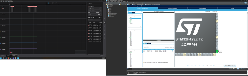

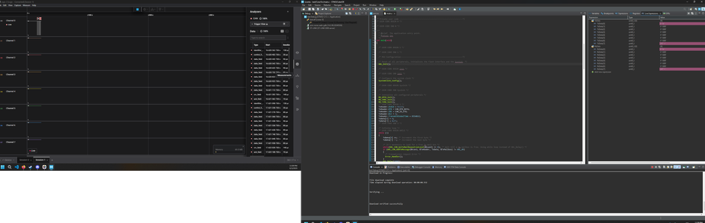

Hello @mƎALLEm  , I did a test in loopback mode with only CAN2 enabled. I looked over it with the debugger and the logic analyzer and when configured to PB12 and PB13 I get an error frame
 When I only changed the pins for CAN 2 it worked fine
 And when the pins were configured for PB12 and PB13, the loopback was working fine inside the debugger, only the readings from PB13 were wrong. Please let me know if the screenshots are blurry.
