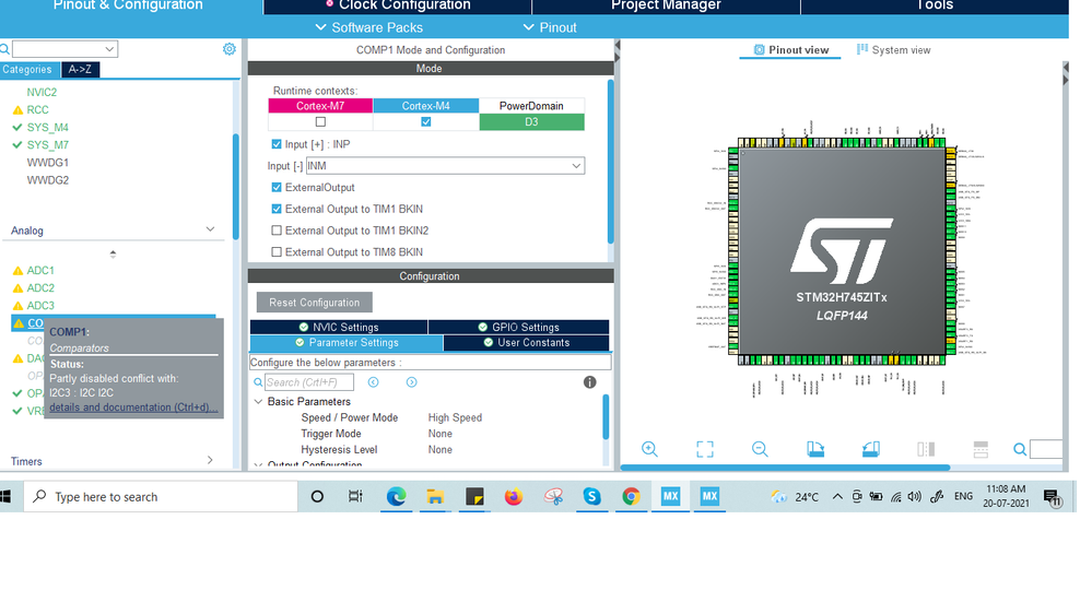

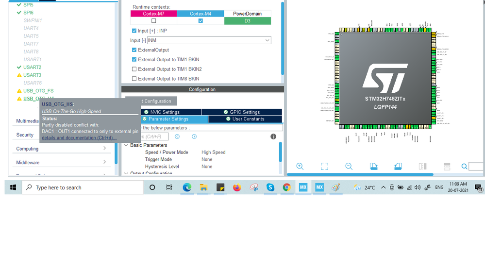

I am working on STM32h745Zitx controller.If i enable the USB_HS peripherals then i select the I2C1 in that yellow icon is present and shows the message that partly disabled conflict with
USB_OTG_HS :External Phy Device_only.

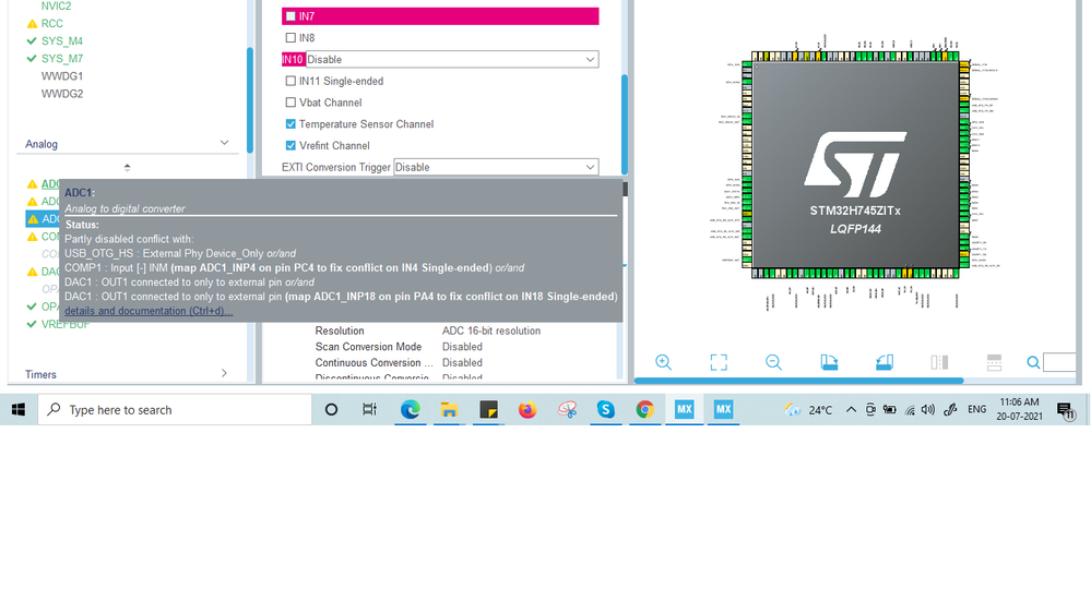

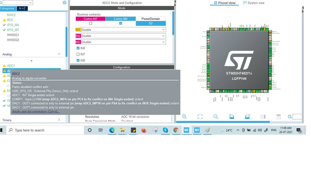

Similarly all the peripherals shows that error i added the images of it . It is compulasary to remove the yellow icon or we cam move forward with that pin configuration. Someone can help me please?

For additional help please read UM1718, the user manual of STM32CubeMX, which is also accessible via STM32CubeMX > Help > Help, section 4.4 Pinout & Configuration view (currently page 64) and table 5 (Component list, mode icons and color schemes).
Summary: yes, you can move forward.
Good luck!

i just want to ask you that yellow sign means the peripherals get intialized but another specification of tht peripheralas get disable it means that can you explain me please
