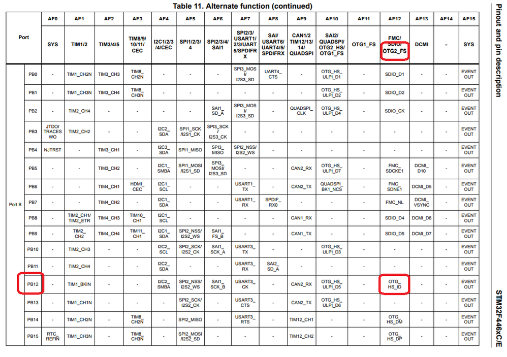

Why CubeMX 4.24 says that PB12 conflicts with USB_OTG_HS when external HS PHY is not is use?
The MCU is F446ZCT, its USB HS core is in FS, host only mode, Activate_SOF and Activate_VBUS unchecked.
PB12 can have two alternate functions for USB HS core - but both are related only to HS mode, correct?
So why conflict with the PHY in FS internal PHY mode?
(and, by the way, what does ''Activate_VBUS'' in host mode? I use a different output pin to switch VBUS to the port).

,On the datasheet, we are mentioning that the STM32F446 MCU have:
If you are using the second on chip FS PHY (GPIOB), the related pins are described as HS because they are linked to the USB 2.0 high-speed/full-speed device/host/OTG controller.
On the datasheet, you may notice that the PB12 is the OTG_HS_ID in the OTG2_FS peripheral.You may also notice that also PB14 and PB15 are mentioned as ''USB_OTG_

Khouloud,
in the opening post, Pavel wrote:
host only mode
What would be the function of ID pin in host-only mode?
Host only
– The force host mode bit (FHMOD) in the OTG USB configuration register(OTG_GUSBCFG) forces the OTG_FS/OTG_HS core to work as a USB host-only.In this case, the ID line is ignored even if present on the USB connector.Jan

, Ihave checked this point and you are right.pavel_a
,the yellow warning on CubeMX indicates that at least one mode configuration is no longer available (Colored in red: OTG/Dual_Role_Device in your case). I apologize if my first answer was misleading. The good news is, if you're in 'Host only' mode, the PB12 pin could be used by other peripherals.Khouloud.
