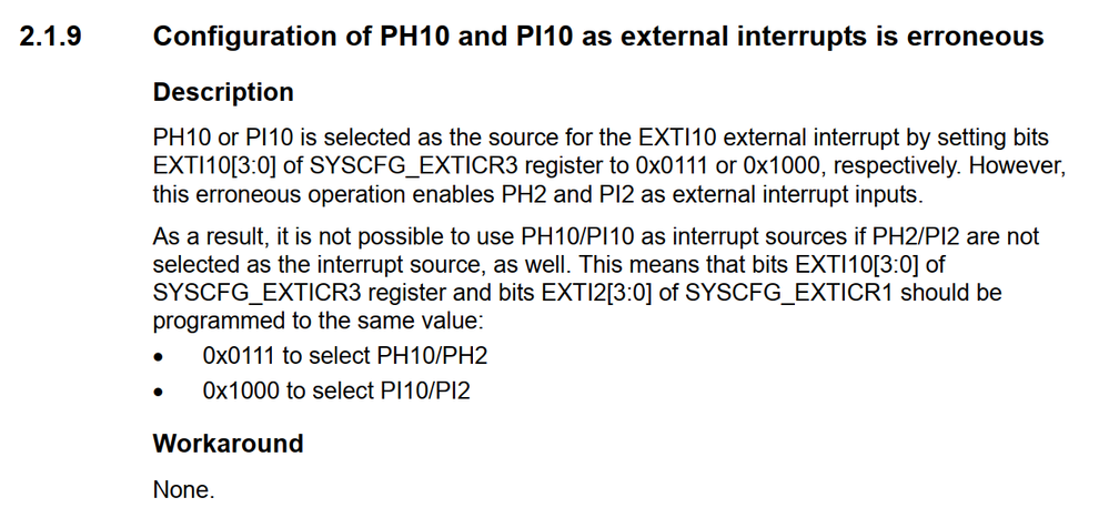

2020-06-08 9:13 AM
So, I found the issue. Its mentioned in the Errata Sheet:
2020-06-08 9:19 AM
If nothing else works, read the fine errata sheet ;)
