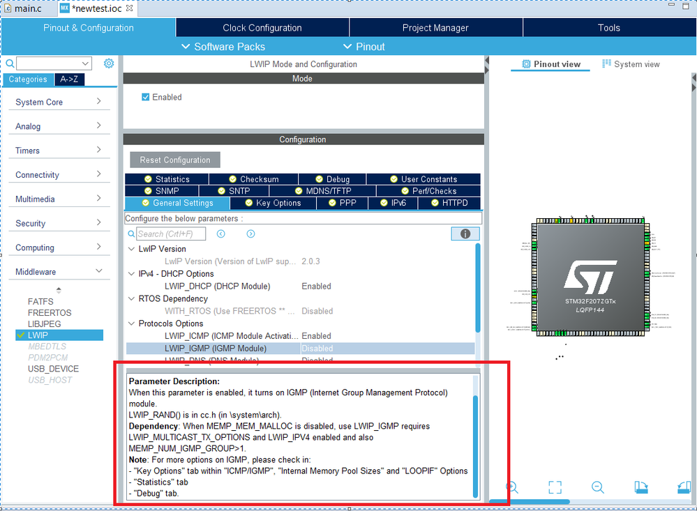

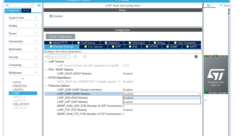

I am using a a very recent version of STM32CubeIDE (Version: 1.3.1) and STM32CubeMX (5.6.1.202004052303). I created a new project for the Nucleo-F207ZG board.
I have enabled LWIP and then enabled UDP but the "IGMP module" has no "enabled" option. Is there some dependency that I am missing?
Can anyone else enable IGMP?

Hi @paulrbryson
Try to read this Parameter description:
You should:
Best regards,
Nesrine

2020-06-08 3:35 PM
Hi @paulrbryson
You should:
Best regards,
Nesrine
2020-06-08 6:19 PM
Wow thank you very much!
I had no idea that those descriptions were there. I may never have clicked on the "i" button and/or I never scrolled past the last parameter. Maybe I need a bigger screen and/or more monitors.
Also I never noticed the "Show Advanced Parameters" check box before.
