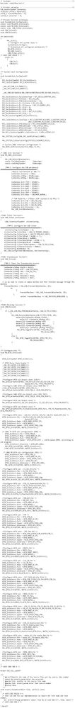

  i am trying to see the CAN Transmitted bits, but i am not understanding my mistake in my program. i have attached my main.c and main.h files. i am using STM32F446RE-Nucleo board using Hal library. Can someone please help me!!
 Thanks in advance.
Following is main.c file:-

Posted on June 17, 2016 at 21:34
What is doing vs not doing?
How do you have this attached to the bus?
What else is attached to the bus?
What do expect it to do?
What does it actually do?
Do any of the functions return error?
What are those errors?
ninad911
Associate III
Posted on June 23, 2016 at 20:34
  i understood my mistake in the program. i forgot to write the API of 'HAL_GPIO_WritePin(GPIO_TypeDef* GPIOx, uint16_t GPIO_Pin, GPIO_PinState PinState)'  in my program.
Thanks for your help.
