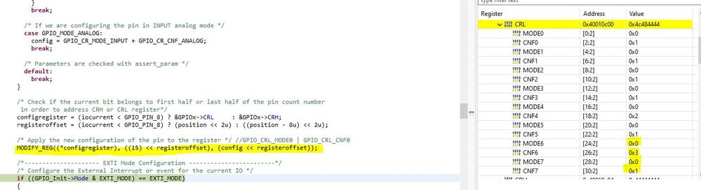

Debugging it seem that HAL_GPIO_Init(GPIOB, &GPIO_InitStruct) in HAL_I2C_MspInit() put Bus busy high.

2021-08-23 12:17 PM
Hello Thanks,
I tried to enable in the CR1 register but i keep getting error before initializing.
About AFIO i don't see anything of strange i would check it better tomorrow.
I checked in the register if was mapped at 0 for pin 6 7 and its fine, i have nothing over i2c1 its an empty project with just swd debug.
Errata was saying what i did (maybe i did it wrong).
Is fine that in GPIO_INIT set pin 6 and 7 as INPUT?
I'm getting MODE 00 and CNF 11 on the table configuration is "reserved".
It doesnt match with what i set up on stmcube that was output open drain with no pullup.
I'll check more tomorrow.
Thanks a lot.
