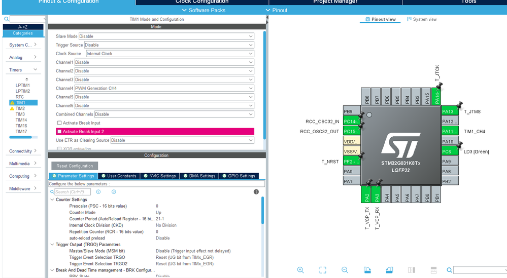

Hi there,
i start to use aSTM32G031 Nucleo with some W2812b . I configure timer1 PWM output but when i try to generate the PWM i just say a lot of noise. I use one library i wrote for another microcontroller and i'm sure work. I share my configuration and i hope someone can help me .
and the code

make sure your GP output pins have their maximum output speed set to something greater than low.
Consider using an SPI port output bit for sending your patterns rather than bit banging.
The WS LEDs are pretty sensitive to timing and there's only two patterns, one for 1 and one for 0. If you can figure out a binary character made up of 00011111 or 11100000 patterns, with the right amount of high and low time, based on the bit width of your SPI, you can just fire out a bunch of characters using DMA.
But first, check your output wave forms with an oscilloscope. They may look terrible.
2022-11-21 2:13 PM
Hi
thanks for your replace.I check the pin with my oscilloscope but i just saw a lot of noie. I set the speed of the port at the max frequency but nothing. Interesting the SPI but if the frequecy of my W2812b i 800Khz my baut rate is ?
