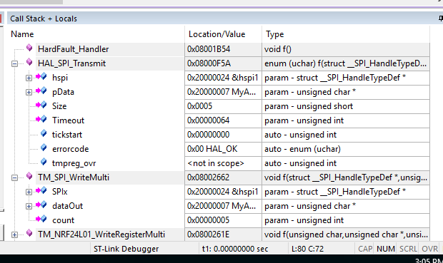

Hello. Sorry for late reply, I did see your message, but I was very busy with other things. Anyway. in the mean time I noticed, that almost for sure, this code segment in HAL_SPI_Transmit() function is the problem.
1.
hspi->Instance->DR = *((uint16_t*)hspi->pTxBuffPtr);
2.
hspi->pTxBuffPtr +=
sizeof
(uint16_t);
3.
hspi->TxXferCount -= 2;
I will investigate this problem further tomorrow, but for now, if any of you more experienced guys can take a look at 8-bit mode of thisHAL_SPI_Transmit() function, and check if it is really what it should be. Other functions such asHAL_SPI_TransmitReceive() seems like they don't hardfault microcontroller (so
hspi->Instance
should point to something useful). >> works with Arduino, >This word is not to be used in a decent society. I've read this sentence 300 times and laughed each time :D Thanks!2016-08-07 2:15 PM

I've just figured out that two boards, configured as full duplex master - slave can normally communicate through SPI with default CubeMX software. This means an error must be somewhere in nrf24l01+ library or passed arguments that cause unaligment.
> Well, this is also not workingIt doesn't cause HardFault, and no SPI status error is generated, but other code concerning nrf24l01 is not working - it says 1 byte is always available even with no nrf module attached. Anyway, I will focus now on nrf library and arguments to HAL_SPI functions as mentioned above.
