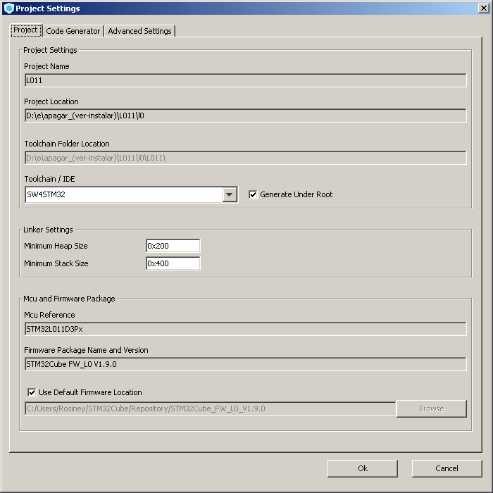

Try changing the values using ''STM32CubeMx'':
The default setting is:
_Min_Heap_Size = 0x200;
_Min_Stack_Size = 0x400;
or 1536 bytes reserved. (75% of 2048).
reduce to:
_Min_Heap_Size = 0x100;
_Min_Stack_Size = 0x200;
or
_Min_Heap_Size = 0x000;
2018-01-12 1:02 PM
I guess care should be taken when playing with stack and the heap. Can reduce the values of these based on the app requirements. e.g. if you allocate an array of 0x200 bytes inside a function (main() is function as well) your app probably crashes as the stack is used by the array.... Also when you use malloc() or dynamic array you can run into trouble with heap when underestimated. Also need to take care when using foreign libs when we do not know what are exact requirements.
