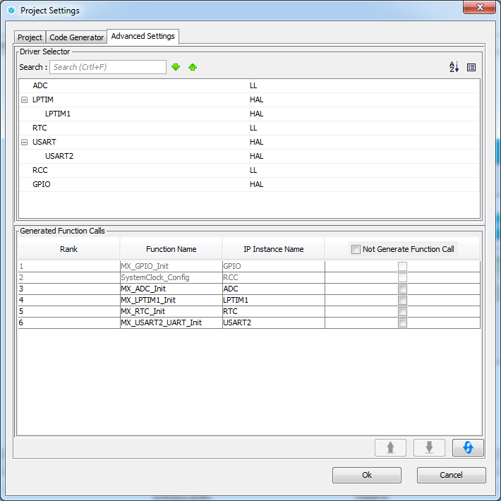

Cube LL drivers is another way to go... I work with small flash a lot and switched to LL
2018-01-11 2:06 AM
Indeed using Cube HAL for STM32 MCUs with small size of Flash could be problematic, because most or all (like in this example) Flash can be consumed by generated code and there is small or no space for user code.
This limitation was a reason why ST introduced some time ago so called Low Layer (LL) libraries. This is an alternative solution to HAL libraries. Thanks to it developers can create applications based on working out of the box API for MCU's resources, but additionaly they benefit from significantly reduced code size. Both HAL and LL are supported by STM32CubeMX and user selects for each peripheral separately HAL or LL. In order to make such configuration inside STM32CubeMX please click in main menu Project -> Settings and in opened window select Advanced Settings tab.
I believe this solution will allow you to fit in MCU's Flash size and still you will be able to use STM32CubeMX and ST libraries (LL) for your application development.
Regards
