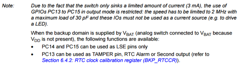

?Please note that you shouldn't use PC13 to drive a LED. This is explained in the RM0008 (page 68):
-Amel

And of course the LED is not drived directly via PC13.
Regards,
Fred.
