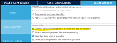

@AAlis.23 Your .ioc has "Generate peripheral initialization as a pair of '.c/.h' files per peripheral" checked.
This is why MX_LWIP_Init is placed in separate file lwip.c/h (along with other per-module files) rather than in main.c.
"Generate code" checkbox for LwIP is unchecked and "Delete previously generated files when not re-generated" is selected. So the remaining question is why lwip.c has not been deleted after re-generation. Maybe because it contains modified user code besides the MX_LWIP_Init().
